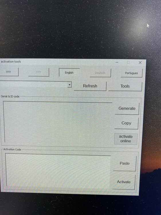

Elvie 0 Posted March 8, 2021 Hi, thank you for your help, I was tried to follow the above steps, and when I reach to third step, tried to activate the firmware with the Activation program and the activation code, there is without any printer model for me to select. I can confirm I download the Activation is WF-C5290 from your web site. (I tried refresh still without any printer model show up) Please help about this part, thank you. Quote Share this post Link to post Share on other sites
Elvie 0 Posted March 8, 2021 Updated for the above situatiion. I tried to use another Laptop, still stuck on the third steps, when install and running the INKCHIP Activation, without any printer model to select and activate online. Thank you. Quote Share this post Link to post Share on other sites

Terry 3 Posted April 5, 2021 Epson xp-15000 stuck at read failed 1 cannot generate serial id code cannot activate online Read failed -1 have code can't insert Quote Share this post Link to post Share on other sites
Terry 3 Posted April 5, 2021 On 4/5/2021 at 3:47 PM, Terry said: Epson xp-15000 stuck at read failed 1 cannot generate serial id code cannot activate online Read failed -1 have activation code can't insert read - 1.pdfread - 1.pdfFetching info... Quote Share this post Link to post Share on other sites

Terry 3 Posted April 5, 2021 I have installed from link sent to another 15000 user call it the 99 solution... It worked so that my serial number was generated within the activation box when I pasted my code into the activation part it would no recognize the number awaiting reply from inkchip Quote Share this post Link to post Share on other sites
Terry 3 Posted April 5, 2021 I have installed from link sent to another 15000 user call it the 99 solution... It worked so that my serial number was generated within the activation box when I pasted my code into the activation part it would no recognize the number awaiting reply from inkchip activation.pdfFetching info... Quote Share this post Link to post Share on other sites
PDAFreaker 0 Posted April 5, 2021 Yep, Just got an e-0mail from them with the 99 solution instructions. Now I'm as far as you are and send them sort of screenshots as you did Fingers crossed Quote Share this post Link to post Share on other sites
PDAFreaker 0 Posted April 5, 2021 (edited) Just got a reaction > You are inserting the key in the wrong place. You need to click the "activate online" button and insert the key in the pop-up window. The key is all the stuff under "ID Code: " That did the trick, its working now!!! Edited April 5, 2021 by PDAFreaker Quote Share this post Link to post Share on other sites
Terry 3 Posted April 5, 2021 Not had any reply myself... unfortunately I have done it the way you suggest but it still asks me for my SN...which is shown in the box anyway so there's something not working for my firmware...glad to see yours has worked...I have just wrote a new item on the forum hopefully someone will answer...good luck Terry Quote Share this post Link to post Share on other sites
