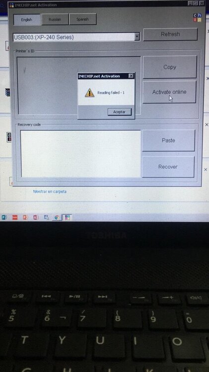

Rykker 0 Posted June 22, 2020 Hi! I uploaded the firmware from your website and it's not working. Rading failed 1 appears on the screen and I can't activate the key. Quote Share this post Link to post Share on other sites
Admin 6 Posted June 22, 2020 Please try this new file for you. https://inkchip.net/download/INKCHIP.net_Firmware_99_XP240_v1.rar 1) Upload firmware which I sent 2) Switch on in normal mode(!!!!) just turn on button . - dont put printer in Program Update mode. (no need to press few buttons while turn on the printer) The uploading process will stuck at 70-80% - it is ok! Open task manager and stop updater process. Printer will blink for about 5-15 minutes - then will power OFF. Now power on the printer - chipless firmware is installed in your printer! Quote Share this post Link to post Share on other sites
Rykker 0 Posted June 22, 2020 I used the firmware for X-241. It was 100% ink. Thanks for the help. Quote Share this post Link to post Share on other sites
