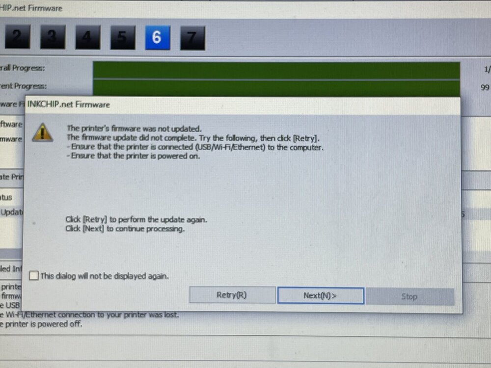

Eileen 0 Posted April 26, 2021 I was able to get the firmware to begin downloading then at 99% it stops and says it cannot complete. I have done everything it tells me to do at this point but it still does not complete I have attached a pic of the screen that comes up. Any help would be appreciated! Quote Share this post Link to post Share on other sites

Becca 0 Posted July 3, 2021 Order #: 159558 I am also having issues with the firmware for my Epson WF-2830. It stops at 99% and then gives me the same error message as Eileen. I have tried multiple times and nothing is working. On 4/26/2021 at 7:42 AM, Eileen said: I was able to get the firmware to begin downloading then at 99% it stops and says it cannot complete. I have done everything it tells me to do at this point but it still does not complete I have attached a pic of the screen that comes up. Any help would be appreciated! Quote Share this post Link to post Share on other sites
Admin 6 Posted July 7, 2021 Your original firmware cannot be downgraded to earlier versions, and our chipless firmware is an earlier version. Basic concepts of the solution: - Standard InkChip firmware. Chipless firmware, which must be loaded into the printer using Firmware Mode. - 99 InkChip firmware. Chipless firmware, which must be loaded into Normal Mode. - Firmware Mode - special mode for updating printer firmware, which is activated when a certain buttons combination is pressed. - Normal Mode - normal mode of operation of the printer, simple switching on the printer with the power button. Algorithm for solving the problem: 1. Check and memorize the firmware version of the printer. The firmware version displayed is the original non-update version. 2. Flash printer 99 with InkChip firmware in Firmware Mode. 3. When trying to activate the firmware with the Activation program and the activation code, the program will generate the Reading failed 1. 4. Start flashing the printer 99 again with InkChip firmware in Firmware Mode. When the firmware status in Firmware Mode reaches 100%, and the printer display finishes counting the percentage of the firmware status, you need to pull out the power cable of the printer. 5. Connect the power cable and turn on the printer. Recovery Mode will appear on the display. 6. Flash the printer with Inkchip firmware in Recovery Mode. 7. Check the firmware version of the printer. The firmware version displayed must be different from the non-renewable firmware version. This version is the chipless firmware version of InkChip. 8. Activate chipless firmware with the Activation program. https://inkchip.net/download/INKCHIP.net_Firmware_99_WF2830_v1.rar This is just an example of a process, it doesn't matter what model of printer you have. Please watch the video on our official YouTube channel: And after that just ran again the inkchip firmware upload in normal mode. Quote Share this post Link to post Share on other sites

Admin 6 Posted July 14, 2021 On 7/12/2021 at 3:53 AM, Becca said: Order #: 159558 What mode did you install the firmware in? Normal mode or update mode? We have recently changed the instructions on our website. Please take a look at them. https://inkchip.net/download/INKCHIP Instruction Method 14 (for 99 firmware).pdf Quote Share this post Link to post Share on other sites
Becca 0 Posted July 14, 2021 9 minutes ago, Admin said: What mode did you install the firmware in? Normal mode or update mode? We have recently changed the instructions on our website. Please take a look at them. https://inkchip.net/download/INKCHIP Instruction Method 14 (for 99 firmware).pdf I've tried both. In normal mode, it goes to 99% and then says the firmware cannot be updated. In update mode, it gives me the fatal error I showed in the video. Quote Share this post Link to post Share on other sites
