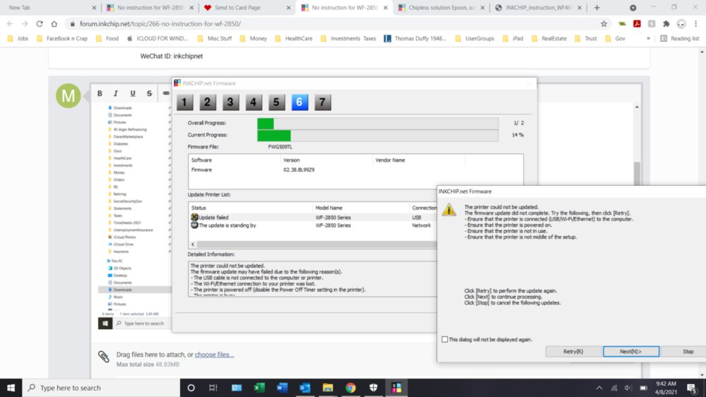

Murphs.World@verizon.net 0 Posted April 8, 2021 (edited) Still failed: And this was AFTER disabling all Firewalls and Antivirus software, appears to hit error at about 14% ?? Edited April 8, 2021 by Murphs.World@verizon.net Quote Share this post Link to post Share on other sites

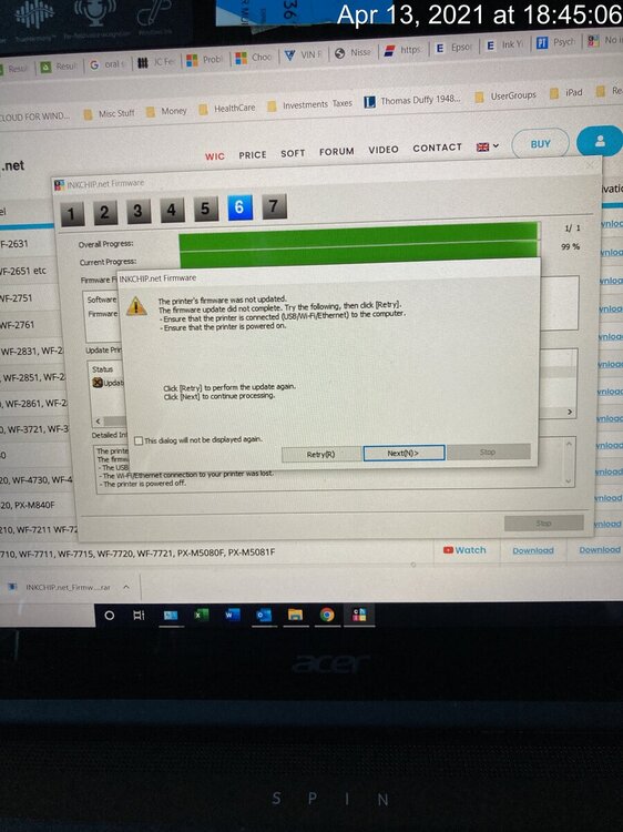

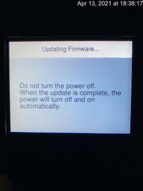

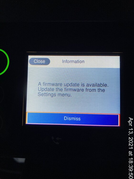

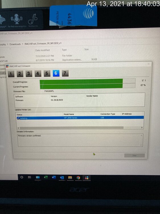

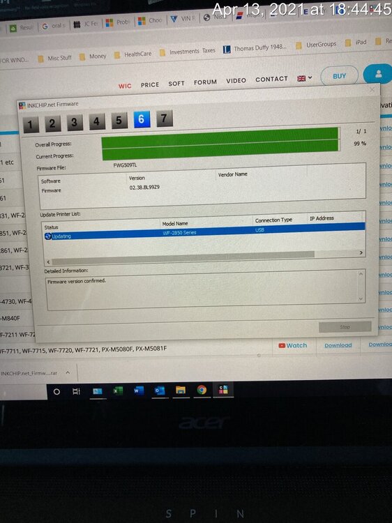

Murphs.World@verizon.net 0 Posted April 13, 2021 Hi, I was correct in that the printer could NOT be updated due to the non-Epson print cartridges were still in the printer, (and thus Epson was complaining). Once I purchased Epson cartridges, the process began as one would expect! Problem now is, per directions above, the update did NOT get stuck between 70/80%, instead the update ran till about 98% and then complained it had not been successful?? Please assist!! Quote Share this post Link to post Share on other sites
Murphs.World@verizon.net 0 Posted April 14, 2021 2 hours ago, Murphs.World@verizon.net said: Hi, I was correct in that the printer could NOT be updated due to the non-Epson print cartridges were still in the printer, (and thus Epson was complaining). Once I purchased Epson cartridges, the process began as one would expect! Problem now is, per directions above, the update did NOT get stuck between 70/80%, instead the update ran till about 98% and then complained it had not been successful?? Please assist!! Quote Share this post Link to post Share on other sites
Murphs.World@verizon.net 0 Posted April 14, 2021 Final portion of the update, hits 99% complete....and then fails! Please help!!! Quote Share this post Link to post Share on other sites
Admin 6 Posted April 24, 2021 Hello! Please try this new file for you: On 4/14/2021 at 4:38 AM, Murphs.World@verizon.net said: Final portion of the update, hits 99% complete....and then fails! Please help!!! Your original firmware cannot be downgraded to earlier versions, and our chipless firmware is an earlier version. Basic concepts of the solution: - Standard InkChip firmware. Chipless firmware, which must be loaded into the printer using Firmware Mode. - 99 InkChip firmware. Chipless firmware, which must be loaded into Normal Mode. - Firmware Mode - special mode for updating printer firmware, which is activated when a certain buttons combination is pressed. - Normal Mode - normal mode of operation of the printer, simple switching on the printer with the power button. Algorithm for solving the problem: 1. Check and memorize the firmware version of the printer. The firmware version displayed is the original non-update version. 2. Flash printer 99 with InkChip firmware in Firmware Mode. 3. When trying to activate the firmware with the Activation program and the activation code, the program will generate the Reading failed 1. 4. Start flashing the printer 99 again with InkChip firmware in Firmware Mode. When the firmware status in Firmware Mode reaches 100%, and the printer display finishes counting the percentage of the firmware status, you need to pull out the power cable of the printer. 5. Connect the power cable and turn on the printer. Recovery Mode will appear on the display. 6. Flash the printer with Inkchip firmware in Recovery Mode. 7. Check the firmware version of the printer. The firmware version displayed must be different from the non-renewable firmware version. This version is the chipless firmware version of InkChip. 8. Activate chipless firmware with the Activation program. https://inkchip.net/download/INKCHIP.net_Firmware_99_WF2850_v1.rar This is just an example of a process, it doesn't matter what model of printer you have. Please watch the video on our official YouTube channel: And after that just ran again the inkchip firmware upload in normal mode. Quote Share this post Link to post Share on other sites
