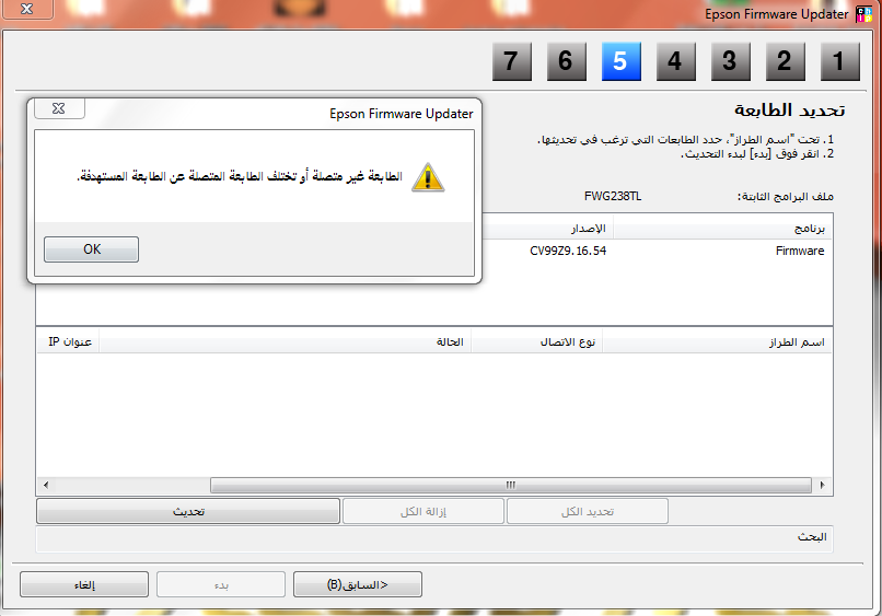

i have a problem  epson wf C5710
Activation: Reading Failed -1
i try to use the firmware 99
the new firmware can't find my printer in the 5th step,
Error: "the printer is disconnected or the printer is different with the model"
[Order #21963] (February 19, 2021)image.png.0517b485c99e158dfbf376199e1cc6b2.png
