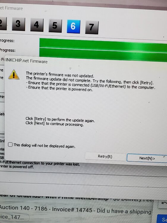

I've tried to update the firmware on my epson wf-2850 fails everytime. I've tried all the suggested resolutions
Please try this new file for you.
https://inkchip.net/download/INKCHIP.net_Firmware_99_WF2850_v1.rar
1) Upload firmware which I sent
2) Switch on in normal mode(!!!!) just turn on button . - dont put printer in Program Update mode. (no need to press few buttons while turn on the printer)
The uploading process will stuck at 70-80% - it is ok!
Open task manager and stop updater process.
Printer will blink for about 5-15 minutes - then will power OFF.
Now power on the printer - chipless firmware is installed in your printer!
