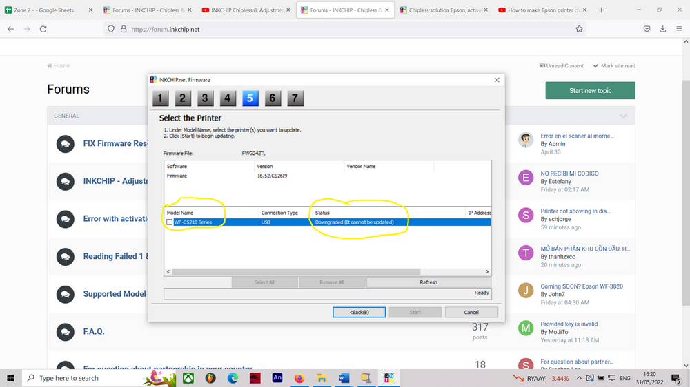

In the photo attached on the left circled it wont even let me select the printer to go to the next step of making a start of updating firmware.
The right circled i noticed it says (it can not be upgraded).
How do I bypass this? Do i need to install another firmware to be able to make  a start?
Yes I have window 10 and the printer is brand new out the box with nothing done to it if that helps in anyway. Thank you.
Step 1
Download and extract Zip archive with WF-C5210  Firmware:
https://inkchip.net/download/INKCHIP.net_Firmware_WFC5210_v1.rar
Step 2
Delete all USB printers installed on your PC except that You want to make chipless. Reboot PC, restart printer.
Step 3
Connect printer to PC (with Windows OS) by proper USB cable.
Disable all Epson processes and services.
Step 4
Upload Firmware to printer in the NORMAL MODE (do NOT use service mode yet just start the printer with the power button).
Step 5
When Firmware Update process is complete - printer will restart - usually it will take only a few minutes but can continue for 10-20 minutes in some rare cases.
If process hangs - replug power cable and start printer manually.
Step 6
Now check current firmware version.
If NO - restart the printer and try once more time.
Step 7
Extract all files from License.zip archive to local folder on Your PC. Run activation.exe utility and click on Activate Online button and input Your Activation Key.
