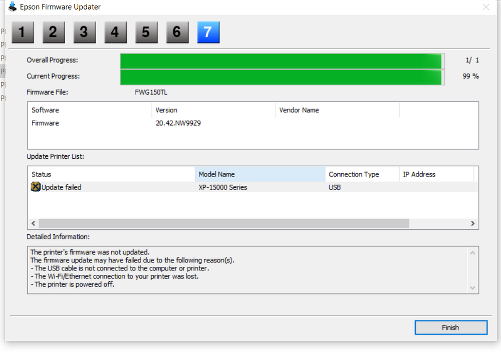

I'm also having issues with the activator software and have this same printer. i got the firmware to install, but the activator is not working. This is the error I am getting. It also seems to look quite a bit different than the software in the tutorial.
Edited by katrelld@gmail.com
Read failed - 1 does not mean there is a problem with the activator, but that the chipless firmware was not successfully installed. Try to repeat the 99 firmware installation process in normal mode.
