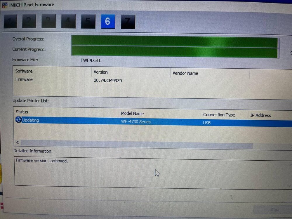

Firmware Update to 99% then says 'not updated'

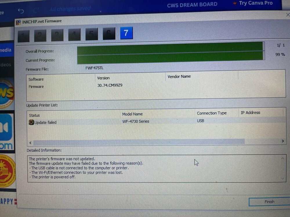

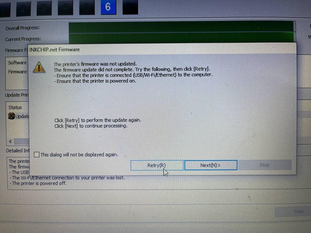

After the Firmware Update process reached 99%, a message pops up "The printer's firmware was not updated". Regarding the troubleshooting listed, everything was followed, but after the 8th time, it is still the same
For the Epson WP-4730, i downloaded Firmware_99_WF4790_v1
On the Firmware Update Program, the version shows 30.74.CM99Z9
Please help
well after quite a few tries i just put my printer in recovery mode and the firmware installed with no problems. so i recommend you look up how to put the printer in recovery mode then do the firmware install
Edited by dragonrage173
Your original firmware cannot be downgraded to earlier versions, and our chipless firmware is an earlier version.
- Firmware Mode - special mode for updating printer firmware, which is activated when a certain buttons combination is pressed.
8. Activate chipless firmware with the key.
This is just an example of a process, it doesn't matter what model of printer you have. Please watch the video on our official YouTube channel: https://www.youtube.com/watch?v=h7qWYWjMNFQ
And after that just ran again the inkchip firmware upload in normal mode.
