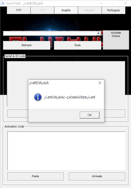

I've had such a frustrating experience with this chipless firmware installation.
Your written instructions state that the firmware version on the printer should change after the chipless firmware has been loaded. However, that's not happening and your support team mentioned to go ahead and activate. I wasn't convinced at first, but after watching some youtuber's videos, I decided to try the activation.
But now this is what's happening with the activation program:
It's printing unreadable text. How do I get past this?
Also, how can I know for certain that the chipless firmware is loaded? Is there not a way to confirm it before trying the activation - as that requires a key purchase.
