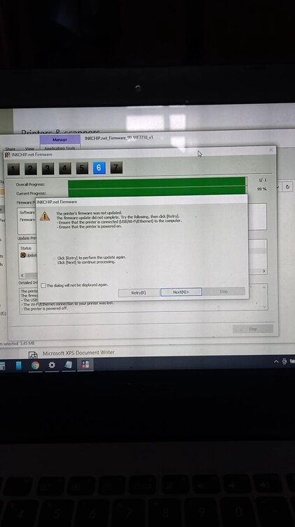

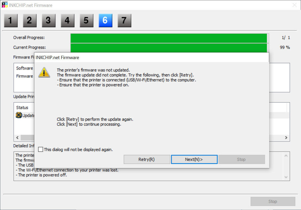

Vincent Decasa 0 Posted November 16, 2021 Hello, I started the chipless conversion process today and I keep getting the error at 99% during the firmware update. I have the Epson WF 7710 and the current firmware version is FA24I5 24/05/2018. I've also attached an image of the error message. Please help. Quote Share this post Link to post Share on other sites

Admin 9 Posted January 12 Hello! Do you using only USB connection to the printer? You should disable network connection. Quote Share this post Link to post Share on other sites
Dragonfly Heart 0 Posted Tuesday at 11:05 PM On 1/12/2023 at 10:13 AM, Admin said: Hello! Do you using only USB connection to the printer? You should disable network connection. I'm also hanging up at 99% . Are you saying that since I've connected by USB to printer, I should disconnect internet connection for my computer? Quote Share this post Link to post Share on other sites
Admin 9 Posted 21 hours ago On 2/1/2023 at 12:05 AM, Dragonfly Heart said: I'm also hanging up at 99% . Are you saying that since I've connected by USB to printer, I should disconnect internet connection for my computer? Yes, please try only with the use of USB cable. Quote Share this post Link to post Share on other sites
