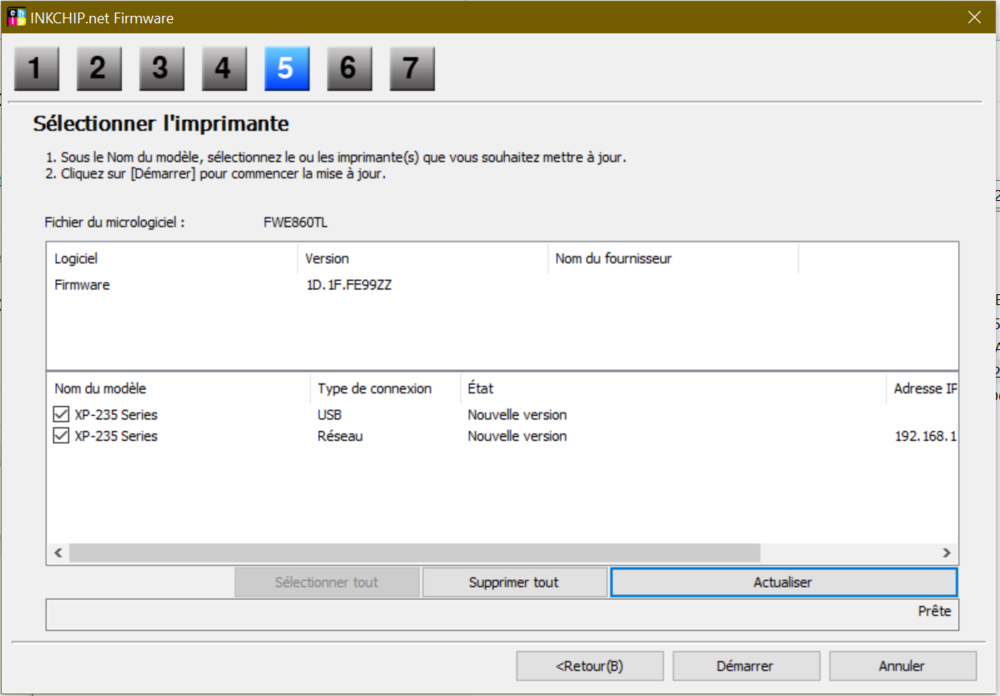

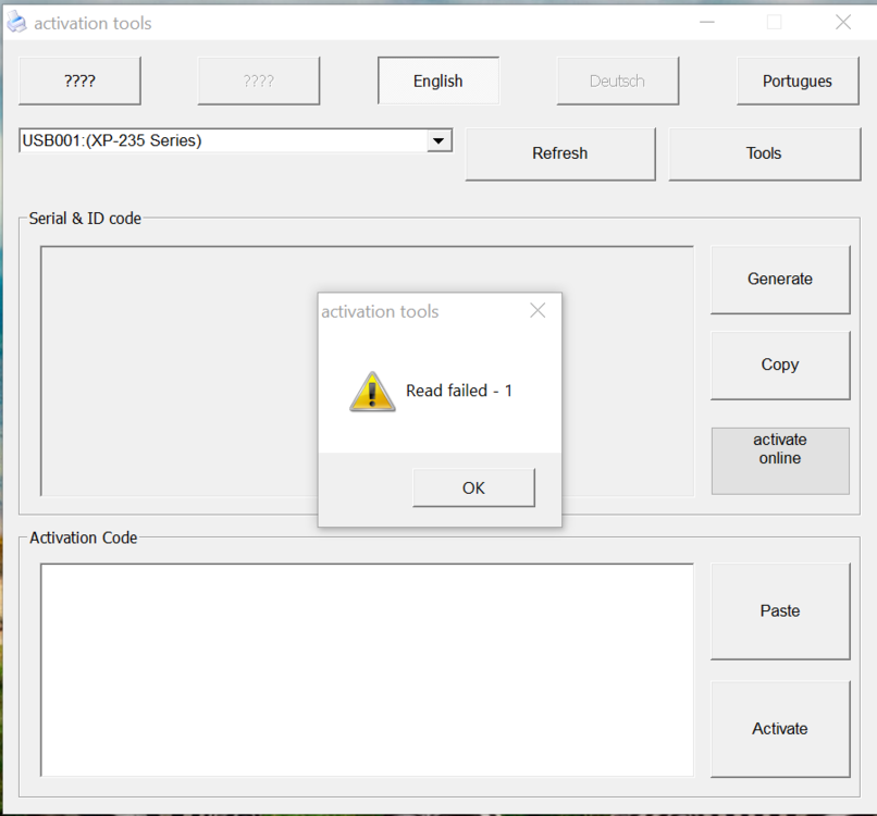

stephx5 0 Posted August 12, 2021 Hello, after loading the firmware into my printer (XP-235), the printer flashes quickly without stopping. I have to press cancel to stop the flashing. On the activation software, I cannot click on "activate online", I have the error message "Read failed -1". Quote Share this post Link to post Share on other sites
Admin 9 Posted August 15, 2021 On 8/12/2021 at 3:02 PM, stephx5 said: Hello, after loading the firmware into my printer (XP-235), the printer flashes quickly without stopping. I have to press cancel to stop the flashing. On the activation software, I cannot click on "activate online", I have the error message "Read failed -1". Please try this new file for you. https://inkchip.net/download/INKCHIP.net_Firmware_99_XP235_v1.rar 1) Upload firmware which I sent 2) Switch on in normal mode(!!!!) just turn on button . - dont put printer in Program Update mode. (no need to press few buttons while turn on the printer) The uploading process will stuck at 70-80% - it is ok! Open task manager and stop updater process. Printer will blink for about 5-15 minutes - then will power OFF. Now power on the printer - chipless firmware is installed in your printer! Quote Share this post Link to post Share on other sites

Admin 9 Posted October 28, 2021 Your original firmware cannot be downgraded to earlier versions, and our chipless firmware is an earlier version. Basic concepts of the solution: - Standard InkChip firmware. Chipless firmware, which must be loaded into the printer using Firmware Mode. - 99 InkChip firmware. Chipless firmware, which must be loaded into Normal Mode. - Firmware Mode - special mode for updating printer firmware, which is activated when a certain buttons combination is pressed. - Normal Mode - normal mode of operation of the printer, simple switching on the printer with the power button. Algorithm for solving the problem: 1. Check and memorize the firmware version of the printer. The firmware version displayed is the original non-update version. 2. Flash printer 99 with InkChip firmware in Firmware Mode. 3. When trying to activate the firmware with the Activation program and the activation code, the program will generate the Reading failed 1. 4. Start flashing the printer 99 again with InkChip firmware in Firmware Mode. When the firmware status in Firmware Mode reaches 100%, and the printer display finishes counting the percentage of the firmware status, you need to pull out the power cable of the printer. 5. Connect the power cable and turn on the printer. Recovery Mode will appear on the display. 6. Flash the printer with Inkchip firmware in Recovery Mode. 7. Check the firmware version of the printer. The firmware version displayed must be different from the non-renewable firmware version. This version is the chipless firmware version of InkChip. 8. Activate chipless firmware with the Activation program. https://inkchip.net/download/INKCHIP.net_Firmware_99_WF7710_v1.rar)://inkchip.net/download/INKCHIP.net_Firmware_XP235_v2.rar This is just an example of a process, it doesn't matter what model of printer you have. Please watch the video on our official YouTube channel: https://www.youtube.com/watch?v=h7qWYWjMNFQ And after that just ran again the inkchip firmware upload in normal mode. Quote Share this post Link to post Share on other sites

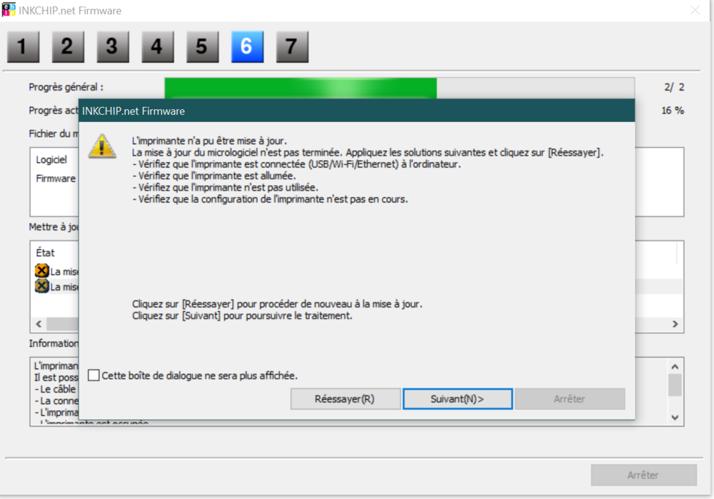

Kith 0 Posted October 1, 2022 Followed instructions but did not work. still stuck at 14% still. Quote Share this post Link to post Share on other sites
Admin 9 Posted October 1, 2022 3 hours ago, Kith said: Followed instructions but did not work. still stuck at 14% still. This might be because there are too many printers on devices and printers. That’s what might help you: close the Activator Software, turn off your printer, go to PC and remove all printers that may be in "Devices and Printers", then turn your printer on and it will install again, then open the launcher software again and it might appear normally. Quote Share this post Link to post Share on other sites
Kith 0 Posted October 4, 2022 On 10/2/2022 at 12:22 AM, Admin said: This might be because there are too many printers on devices and printers. That’s what might help you: close the Activator Software, turn off your printer, go to PC and remove all printers that may be in "Devices and Printers", then turn your printer on and it will install again, then open the launcher software again and it might appear normally. I followed all your instructions. It did not work. I'm tired and disappointed that this is not working for me. Quote Share this post Link to post Share on other sites
Admin 9 Posted October 6, 2022 On 10/4/2022 at 8:25 AM, Kith said: I followed all your instructions. It did not work. I'm tired and disappointed that this is not working for me. Hello, I see that you failed to install the firmware. You must install the firmware in normal mode. To install the firmware in normal mode means to use only the power button. Watch this video please: https://youtu.be/oF0DsDVPT7k Here’s the new firmware: https://inkchip.net/download/INKCHIP.net_Firmware_99_XP235_v1.rar Quote Share this post Link to post Share on other sites
