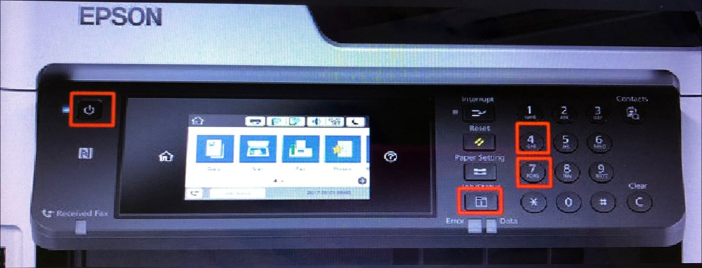

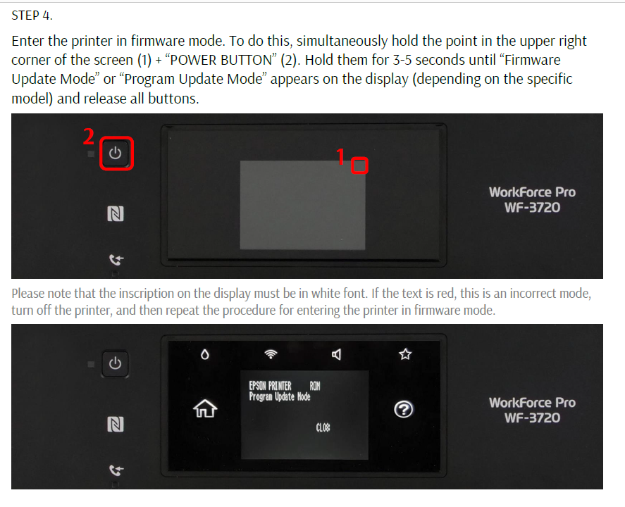

i use epson printer c869r
i try to use chipless firmware, but the video tutorial in this link not work for me.
ca Admin give the update tutorial ?
the 4th step is now work!
