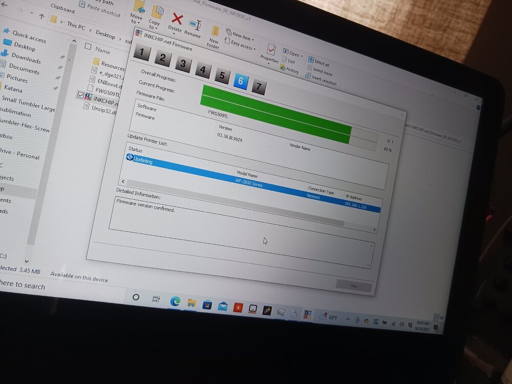

WF-2850 updated firmware on printer, but system won't recognize so I can't activate.
My Epson Wf-2850 Firmware shows the BLK05K3, however the Inkchip Firmware on my computer will not show that the firmware is on my printer and will not allow me to complete step 7 of the firmware update process. Since I cannot finish this process, I cannot activate the chipless firmware.
I had to install the firmware in recovery mode, as the normal USB process failed every time.
Please tell me how to get the firmware screen to recognize the firmware that is on my printer so I can activate.

18 hours ago, Loudog75 said:
ok, so firmware should be installed but, now the activation doesnt list my device so i can activate it
Hello,
This might be because there are too many printers on devices and printers. That’s what might help you: close the Activator Software, turn off your printer, go to PC and remove all printers that may be in "Devices and Printers", then turn your printer on and it will install again, then open the launcher software again and it might appear normally.
