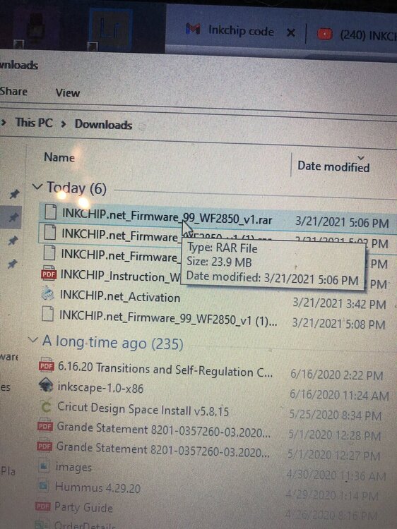

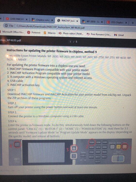

BWeir 0 Posted March 21, 2021 I just bought the firmware to have a chip less ink cartridge system in my printer. I have downloaded all the necessary items that were Included but when trying to open the firmware, there is nothing that is coming up. I also clicked on instructions for my printer and it is showing instructions for a different printer. So I’m not sure how to get into the firmware mode. Any help is appreciated! Brittney Weir Quote Share this post Link to post Share on other sites

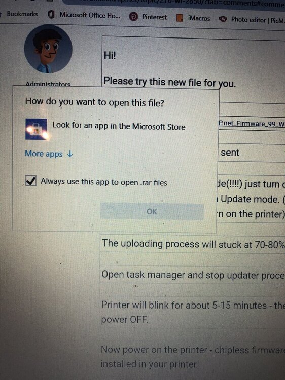

BWeir 0 Posted March 22, 2021 Now I’ve downloaded a program and am able to install firmware. I click on it and Computer askes if ok to install. After clicking on yes, an error box appears with "could not find files needed to start." what am I doing wrong? Quote Share this post Link to post Share on other sites
Admin 12 Posted March 22, 2021 11 hours ago, BWeir said: Now I’ve downloaded a program and am able to install firmware. I click on it and Computer askes if ok to install. After clicking on yes, an error box appears with "could not find files needed to start." what am I doing wrong? Hello! Please try this new file for you: https://inkchip.net/download/INKCHIP.net_Firmware_99_WF2850_v1.rar 1) Upload firmware which I sent 2) Switch on in normal mode(!!!) just turn on button . - dont put printer in Program Update mode. (No need to press few buttons while turn on the printer) The uploading process will stuck at 70-80% - it is ok! Open task manager and stop updater process. Printer will blink for about 5-15 minutes - then will power OFF. Now power on the printer - chipless firmware is installed in your printer! Quote Share this post Link to post Share on other sites
