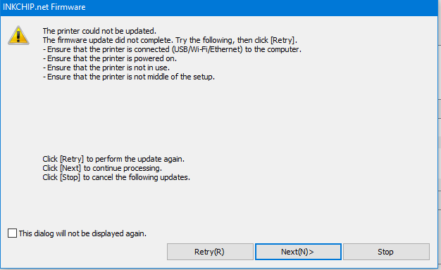

AJs 0 Posted February 20, 2021 So I'm pressing the stop, colour copy, wifi and power button and..... it turns on like normal. But it just won't enter recovery mode so I can install the new firmware. I've watched you tube videos, spent an hour Googling and all instructions seem to fail. Is there something I'm doing wrong? Quote Share this post Link to post Share on other sites
Admin 6 Posted February 20, 2021 Hi! Please try this new file for you. https://inkchip.net/download/INKCHIP.net_Firmware_99_XP240_v1.rar 1) Upload firmware which I sent 2) Switch on in normal mode(!!!!) just turn on button . - dont put printer in Program Update mode. (no need to press few buttons while turn on the printer) The uploading process will stuck at 70-80% - it is ok! Open task manager and stop updater process. Printer will blink for about 5-15 minutes - then will power OFF. Now power on the printer - chipless firmware is installed in your printer! Quote Share this post Link to post Share on other sites
Admin 6 Posted February 21, 2021 Your original firmware cannot be downgraded to earlier versions, and our chipless firmware is an earlier version. Basic concepts of the solution: - Standard InkChip firmware. Chipless firmware, which must be loaded into the printer using Firmware Mode. - 99 InkChip firmware. Chipless firmware, which must be loaded into Normal Mode. - Firmware Mode - special mode for updating printer firmware, which is activated when a certain key combination is pressed. - Normal Mode - normal mode of operation of the printer, simple switching on the printer with the power button. Algorithm for solving the problem: 1. Check and memorize the firmware version of the printer. The firmware version displayed is the original non-update version. 2. Flash printer 99 with InkChip firmware in Firmware Mode. 3. When trying to activate the firmware with the Activation program and the activation code, the program will generate the Reading failed 1. 4. Start flashing the printer 99 again with InkChip firmware in Firmware Mode. When the firmware status in Firmware Mode reaches 100%, and the printer display finishes counting the percentage of the firmware status, you need to pull out the power cable of the printer. 5. Connect the power cable and turn on the printer. Recovery Mode will appear on the display. 6. Flash the printer with Inkchip firmware in Recovery Mode. 7. Check the firmware version of the printer. The firmware version displayed must be different from the non-renewable firmware version. This version is the chipless firmware version of InkChip. 8. Activate chipless firmware with the Activation program. This is just an example of a process. It doesn't matter what model of printer you have. This video is in Russian, but you can turn on English subtitles : https://www.youtube.com/watch?v=Duyj-UHbzxE And after that just ran again the inkchip firmware upload in normal mode. https://inkchip.net/download/INKCHIP.net_Firmware_99_XP240_v1.rar Quote Share this post Link to post Share on other sites
