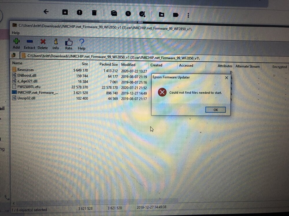

I too have an epson 2850. I have tried the software on your site, also the software you emailed me, and just now the download that was in a message from another person on this page.
I keep getting an Epson message dialog box that says "cannot find files needed to start" .  Im not sure what to do. do you know why this is occurring and how to fix it?

Good afternoon!
Send a screenshot of the error so we can help you.

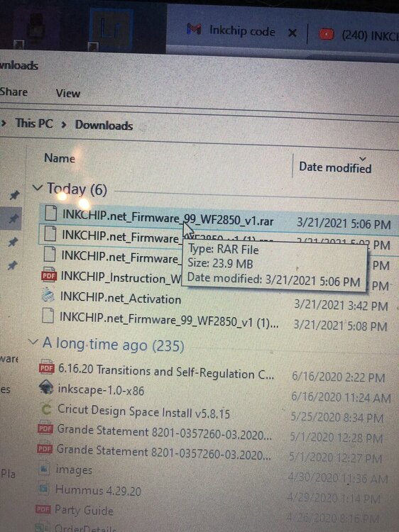

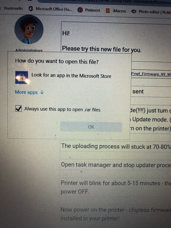

I just bought the firmware to have a chip less ink cartridge system in my printer. I have downloaded all the necessary items that were Included but when trying to open the firmware, there is nothing that is coming up. I also clicked on instructions for my printer and it is showing instructions for a different printer. So I’m not sure how to get into the firmware mode.
Any help is appreciated!
Brittney Weir

So I downloaded what you sent. It still says could not find files to start. I even turned off my firewall on my computer and made sure my computer was completely up to date. Nothing is working.
Good day!
To extract a file you need to use any archiver. For example, WinRAR or other...

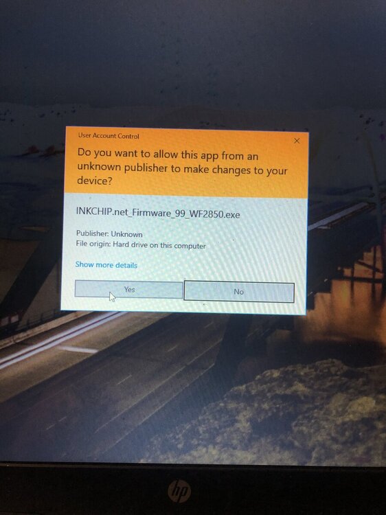

Hello
I used winzip to open firmware_99 file as per link above.
The printer turned off and on around 80 ish % after that a message showed the process  update failed.
I stopped it using task manager.
My printer WF 2850 now shows firmware BL05K3
Is this correct?
I have not tried to use my activation code yet?

Hi! Now run the activation program and insert the key.
Let me know the result.

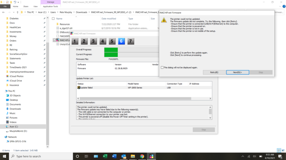

Has anyone gotten this process to successfully complete?
Mine states "The firmware update printer could not be updated":
I wonder if the issue is that I am NOT currently using EPSON Ink, so the printer is still attempting to use the Non-Epson Ink I previously had installed?
Perhaps this is the "Ensure that the printer is not middle of the setup."?
Please help!
Edited by Murphs.World@verizon.net
Your original firmware cannot be downgraded to earlier versions, and our chipless firmware is an earlier version.

This is just an example of a process, it doesn't matter what model of printer you have. Please watch the video on our official YouTube channel: https://www.youtube.com/watch?v=h7qWYWjMNFQ
And after that just ran again the inkchip firmware upload in normal mode.

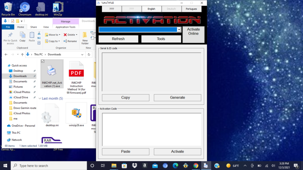

I was having the same issues and then I did end the task at 87% and went to settings and looked at the firmware listed and it had the updated firmware from inkchip. My problem is now when I go to the activation program I try to choose device and the menu is blank. I try to activate online and it says I have to choose a device first. .
Edited by MimiMousey
If you have the latest Windows OS, you should try installing the firmware from another computer with an earlier OS. Installation will take about 15 minutes, after which you can use the printer as before, with any computer.
Hi! If you have the latest Windows OS, you should try installing the firmware from another computer with an earlier OS. Installation will take about 15 minutes, after which you can use the printer as before, with any computer.
