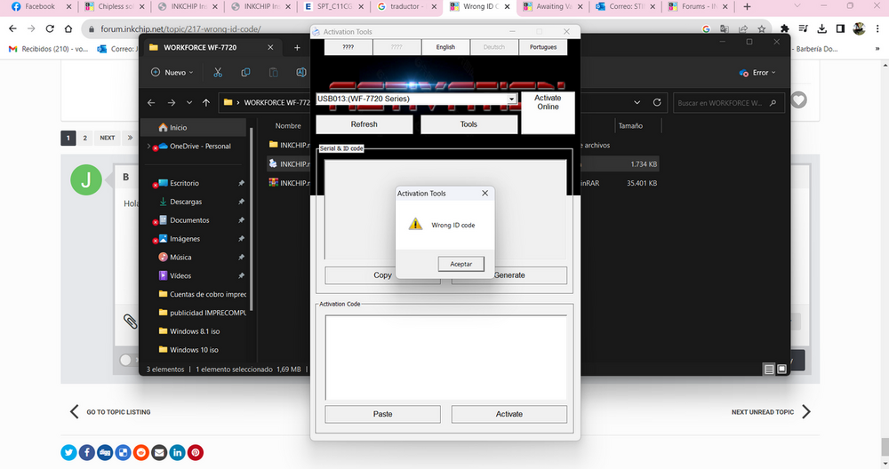

Admin 17 Posted December 15, 2021 3 hours ago, Juan Carlos said: hola también tengo problemas con una wf-2630 me genera el mismo error. ¡Hola! Debe convencerse de que instala el firmware sin chip en el modo NORMAL en lugar del modo ACTUALIZAR. Lea atentamente las instrucciones de nuestro sitio web: https://inkchip.net/download/INKCHIP Instruction Method 14 (for 99 firmware).pdf Además, mire la guía de video de nuestro canal oficial de YouTube: https://youtu.be/oF0DsDVPT7k Si tiene algún problema, ¡escríbanos! ¡Gracias! Quote Share this post Link to post Share on other sites

Ramrod 0 Posted August 16, 2022 Hello, I downloaded the followed all the steps in your instructions and downloaded the firmware and installed it successfully on my printer, (WF-3733). I then purchased the activation key. When I go to activate it via your "Activation Tool", I get the "Wrong ID Code" error. How do I fix this so I can use my printer? Quote Share this post Link to post Share on other sites
Admin 17 Posted August 16, 2022 Your original firmware cannot be downgraded to earlier versions, and our chipless firmware is an earlier version. Basic concepts of the solution: - Standard InkChip firmware. Chipless firmware, which must be loaded into the printer using Firmware Mode. - 99 InkChip firmware. Chipless firmware, which must be loaded into Normal Mode. - Firmware Mode - special mode for updating printer firmware, which is activated when a certain buttons combination is pressed. - Normal Mode - normal mode of operation of the printer, simple switching on the printer with the power button. Algorithm for solving the problem: 1. Check and memorize the firmware version of the printer. The firmware version displayed is the original non-update version. 2. Flash printer 99 with InkChip firmware in Firmware Mode. 3. When trying to activate the firmware with the Activation program and the activation code, the program will generate the Reading failed 1. 4. Start flashing the printer 99 again with InkChip firmware in Firmware Mode. When the firmware status in Firmware Mode reaches 100%, and the printer display finishes counting the percentage of the firmware status, you need to pull out the power cable of the printer. 5. Connect the power cable and turn on the printer. Recovery Mode will appear on the display. 6. Flash the printer with Inkchip firmware in Recovery Mode. 7. Check the firmware version of the printer. The firmware version displayed must be different from the non-renewable firmware version. This version is the chipless firmware version of InkChip. 8. Activate chipless firmware with the Activation program. https://inkchip.net/download/INKCHIP.net_Firmware_99_WF3720_v1.rar This is just an example of a process, it doesn't matter what model of printer you have. Please watch the video on our official YouTube channel: And after that just ran again the inkchip firmware upload in normal mode. Quote Share this post Link to post Share on other sites

Admin 17 Posted September 13, 2023 20 hours ago, Juan Marin said: Hola tengo un problema activando mi impresora con software inkchip.net, además cuento con un código de activación que no es posible utilizar así. ¡Hola! Debe instalar el firmware sin chip en modo NORMAL en lugar de en modo ACTUALIZAR. Lea atentamente las instrucciones de nuestro sitio web: https://inkchip.net/download/INKCHIP Instruction Method 14 (for 99 firmware).pdf Además, mire la guía en video de nuestro canal oficial de YouTube: https://youtu.be/oF0DsDVPT7k Quote Share this post Link to post Share on other sites
roberto.montagna-bobo 0 Posted October 31, 2023 Buongiorno ho lo stesso problema sulla mia wf 2630 non riesco ad attivare la chiave quando clicco su attiva on line mi appare la scritta wrong id code cosa devo fare? Quote Share this post Link to post Share on other sites
Admin 17 Posted November 3, 2023 On 12/15/2021 at 3:58 PM, Juan Carlos said: hola también tengo problemas con una wf-2630 me genera el mismo error. Debe convencerse de que instaló el firmware sin chip en modo NORMAL en lugar del modo ACTUALIZAR. Lea atentamente las instrucciones de nuestro sitio web: https://inkchip.net/download/INKCHIP Instruction Method 14 (for 99 firmware).pdf Además, mire la guía en video de nuestro canal oficial de YouTube: https://youtu.be/oF0DsDVPT7k Quote Share this post Link to post Share on other sites
