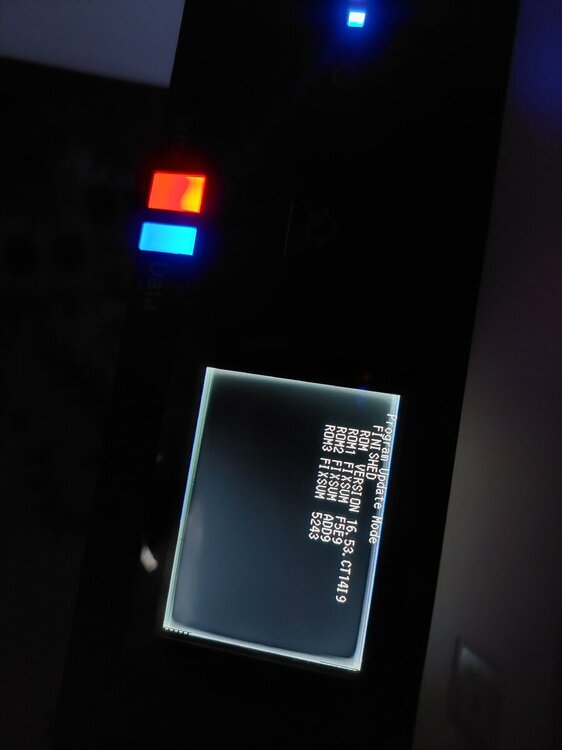

help me solve error when updating firmware to inkchip firmware
my printer wf -c5290 suddenly enter recovery mode
still recovery mode after restart

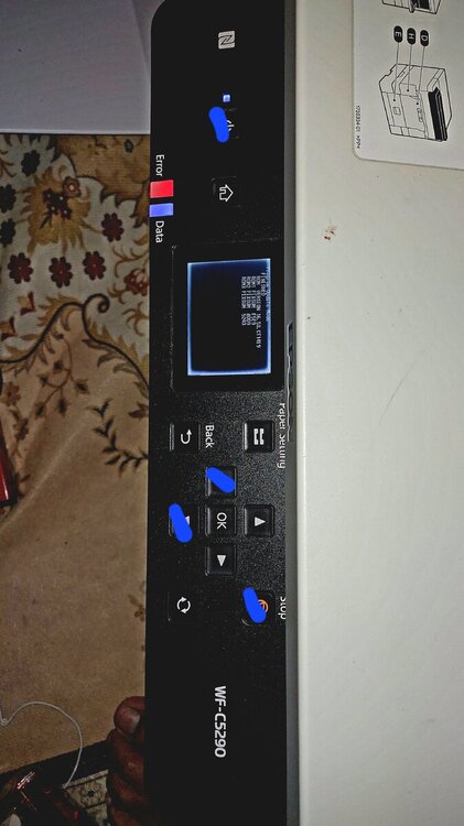

i try using method
power+ down arrow+Left arrow+ reset
it enter recovery mode, then i try install firmware, it detect. but seem the firmware not same with provided
then after finish i off then on back still same program update mode

You should install the Chipless Firmware in NORMAL mode instead of UPDATE mode.
Please read the instruction from our website carefully:
https://inkchip.net/download/INKCHIP Instruction Method 14 (for 99 firmware).pdf
Also, please watch the video guide from our official YouTube channel:
https://youtu.be/oF0DsDVPT7k
Let me know the result!
