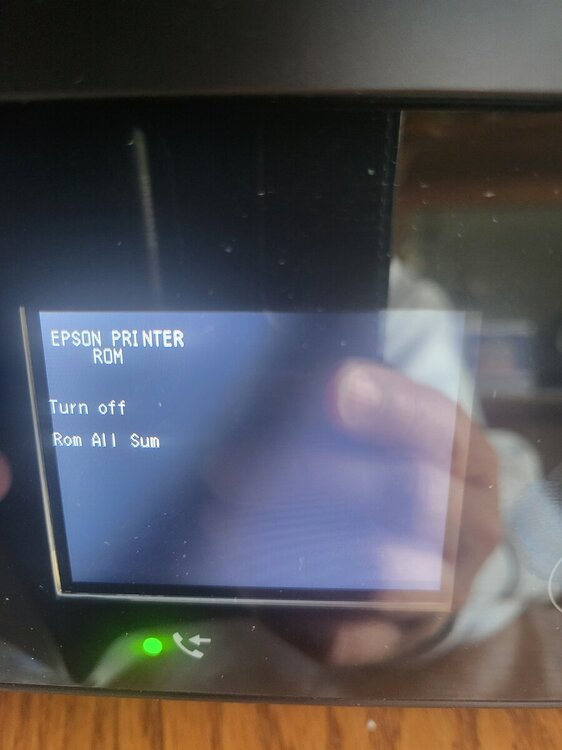

KSB 0 Posted March 5 And now I have this screen on the printer. Quote Share this post Link to post Share on other sites
