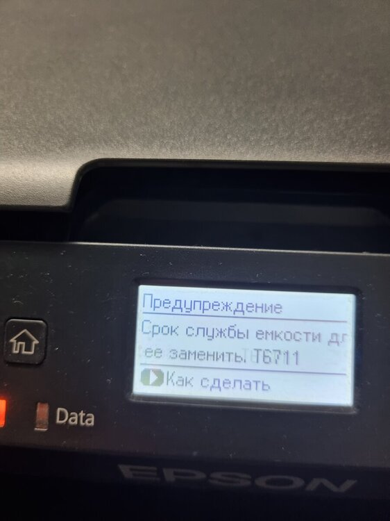

the waste ink cartridge is not reset on wf 7210
the waste ink cartridge is not reset when a new one is installed on wf 7210 inkchip activated.  I need to write firmware with no activatio, then it reset, and after it i do activation.
