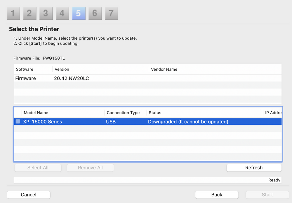

I then tried to roll back the firmware to an older model. I tried roll back firmware update and it shows status "downgraded (It can not be upgraded)" picture attached shows.

Your original firmware cannot be downgraded to earlier versions, and our chipless firmware is an earlier version.
